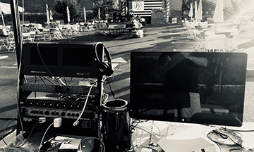

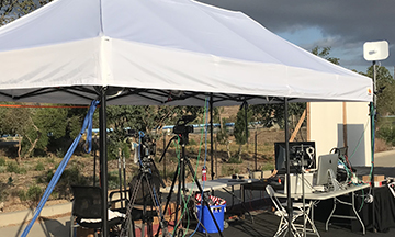

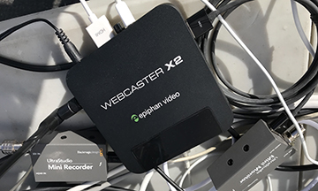

Using 4 Cameras & Computer Graphics - X2’s as encoder outputs
This is a setup with a Blackmagic ATEM Television Studio output to a splitter/converter with 1080p/30 & 720p/30 encoding.
The Blackmagic “ATEM Television Studio” as used equipment (about $550 +/-) is a very inexpensive way to add L3rd’s and use SDI & HDMI connections for computer graphics and cameras. This unit has 4 HDMI & 4 SDI inputs with 6 usable simultaneously. HDMI & SDI outputs.
This setup used AC power (extra quiet Honda generator) lighted host/interview area, 4 cameras and a computer for a graphics/media player.
