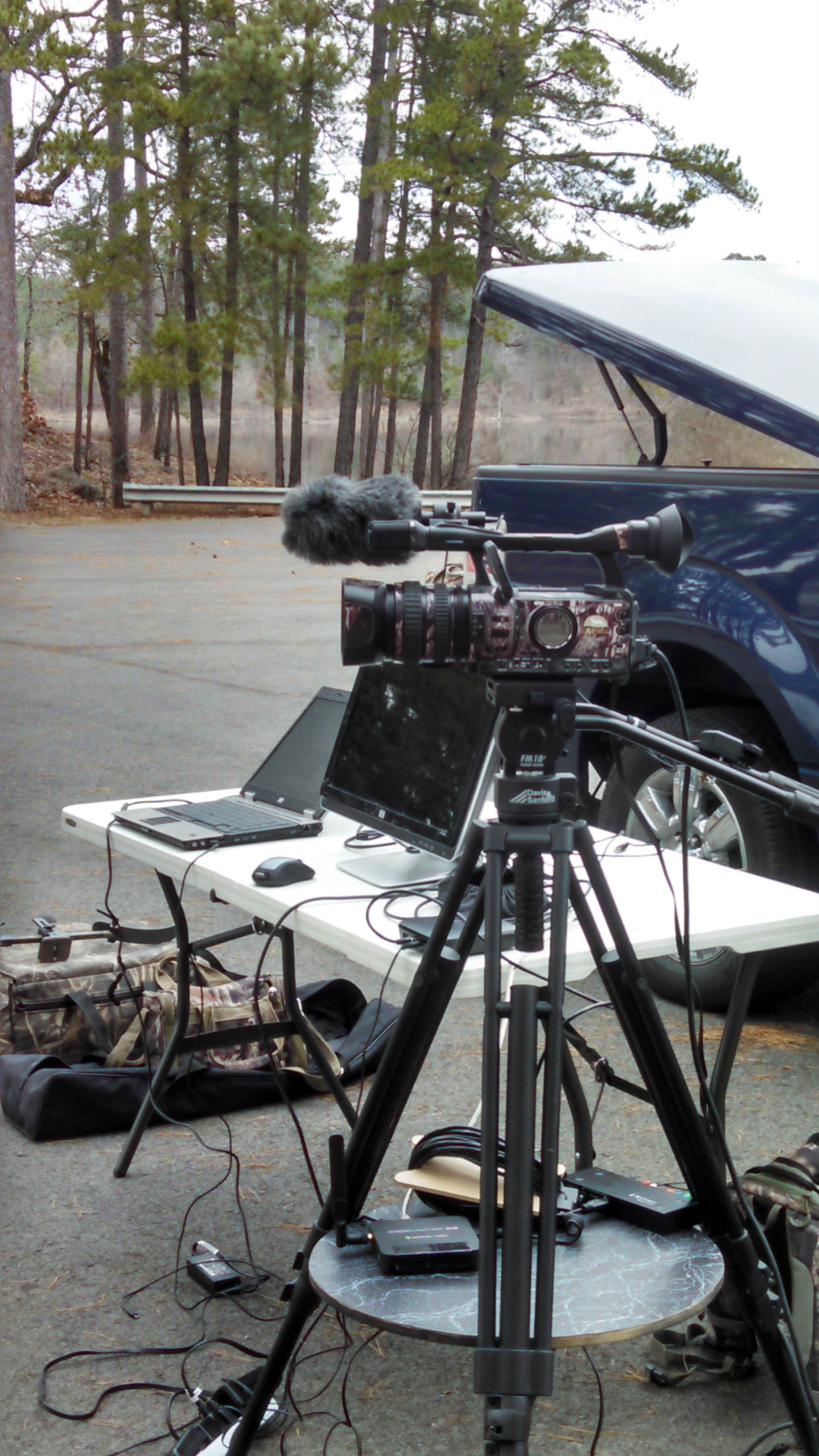

Thanks for your interest. I set up my equipment and done
my test yesterday in the boat ramp parking lot. To my surprise i had a 7.5 megabit signal. I used an att hotspot but i used the ethernet port on the box. I was able to stream at 4 megabits on youtube at 720x1280 I had to stream a 3 megabits on facebook live. The stream looked great Thanks for your help Carroll
